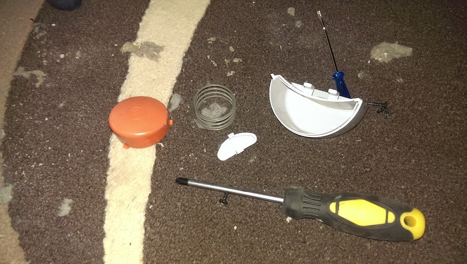

Height adjuster off
Hose off

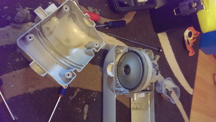

Split the filter housing down next
Motor housing off
Looks familiar...
Aha!
Grabbed the one from the DC04 which was drying at the time
Popped it out of the way, confident that I could sort the horrible sound it makes!

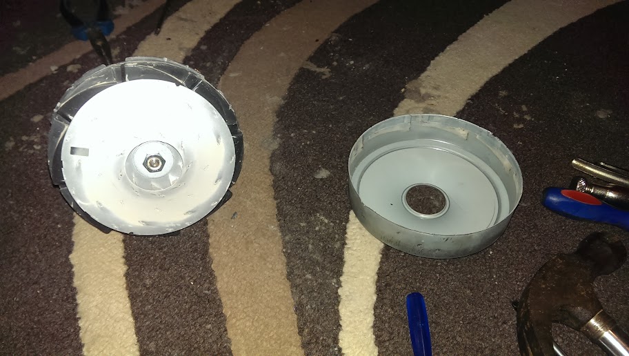

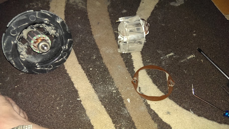

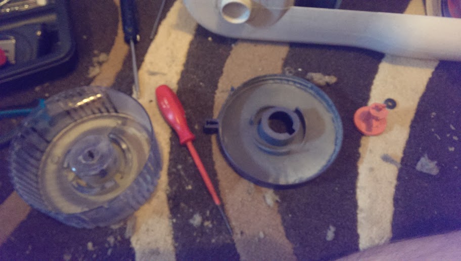

Well sadly there was trouble in paradise! Getting the motor back together last week, I had it all in one piece and was centring the armature as I have done many times before...
tap tap tap tap CRACK  :censored:
Blew the top out of the housing. Was being very gentle too, was very annoyed!
Anyone got a spare one of the above I could purchase off them please? Dont need a whole amtek, but I glued mine together and it runs but isnt level and makes one hell of a noise. Not shelling out for a new motor for it!

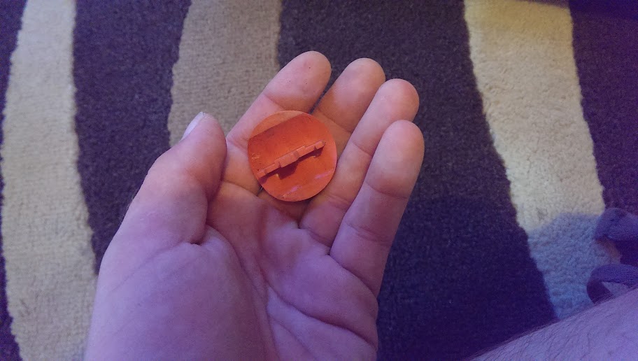

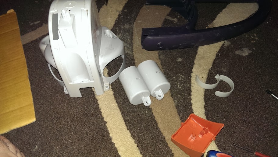

Annoyed by this, and the cord rewind switch cover that kept breaking when I put it in I got the machine together so I didnt loose any parts
I wanted to like it but thanks to  :censored: Candys cost cutting b :censored: it's ruined! Hopei t works well when it has a motor in!
Even more annoyingly I'd ordered some parts for it in readiness for it being back together.  :censored: it mayas well fit them so they dont get lost!
Wrong colour but the chances of finding a blue one are pretty nil so I'm happy with it. For the price it would have been rude not to anyway!

Well the lovely Autovac came up trumps and sent me a lovely broken amtek motor! (The top bearing wasnt there, just the inner race... bet that made a bang when it went...)

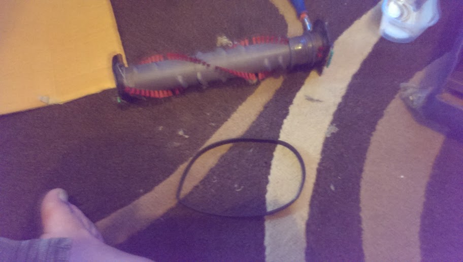

Anyway, I swapped the broken piece off mine for the in tact piece from the broken Amtek, and made a start putting it all together
A non clutched, used dyson belt is a perfect fit!

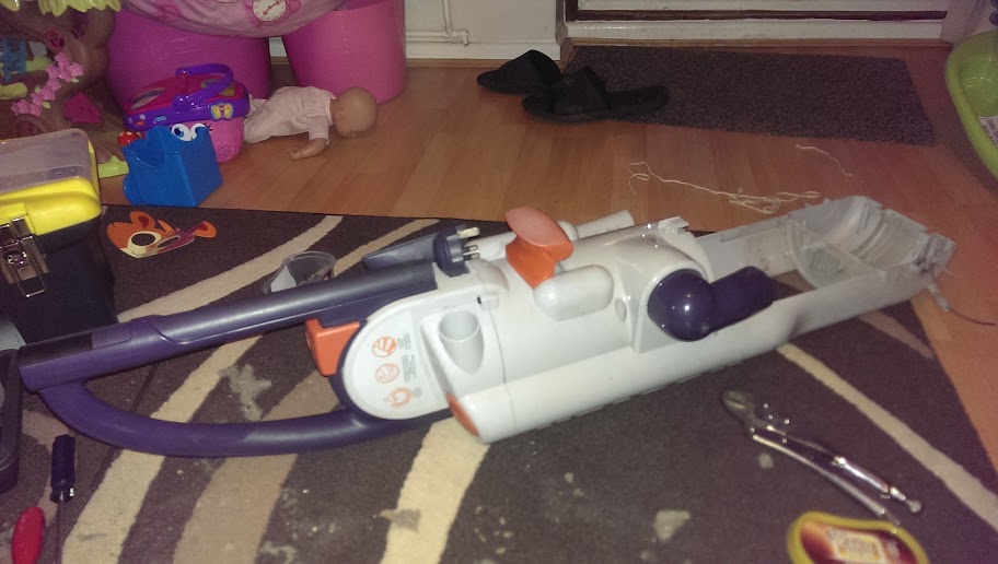

And she works again!(rug had lovely trackmarks in, which the flash on my crappy camera killed...)
Picked up a fair bit too from 2 rugs and the stairs
It did run VERY hot though, although I imagine it did that when new. Filter looked spotless still when checked
And finally, the Vortex is finished! It does work very well, although I can see why most have died by now, bad filtration and hot running picked them off one by one! I do have a video, I'll upload it later!

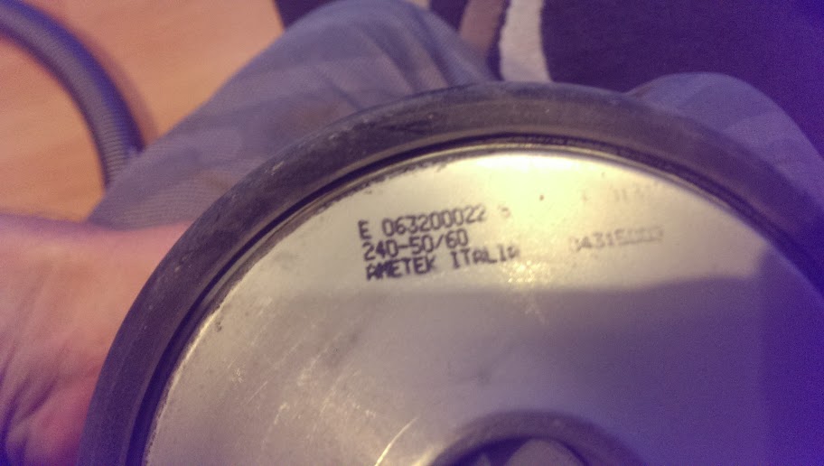

Months and months ago (probably just after crimbo), I saw and bought a new genuine old stock motor for the Vortex. I also added a new brushroll to a q know who order at some point, and the parts have been gathering dust ever since

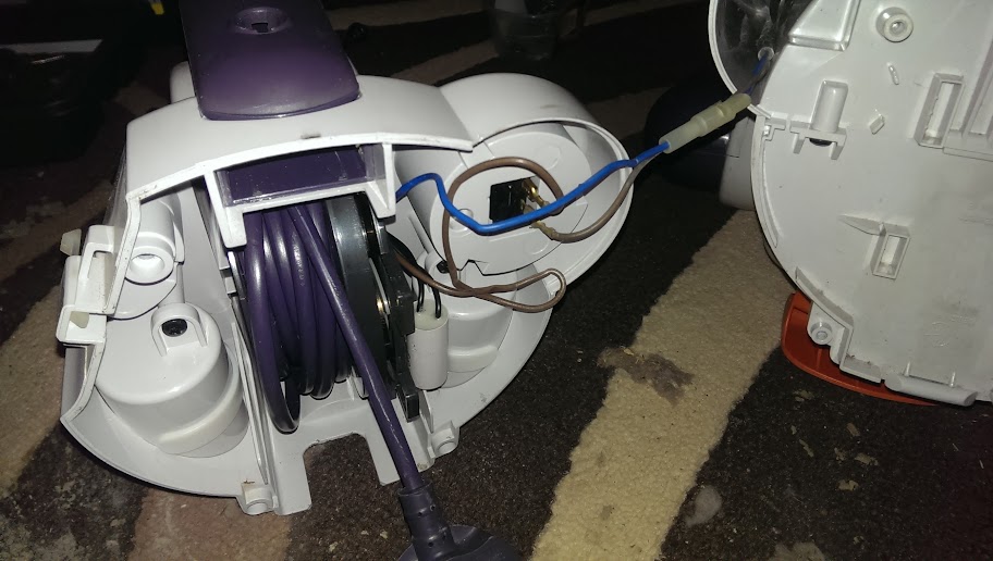

So when I got home from work I popped up into the loft and got out the Vortex!
and got it apart to fit the motor
New cables came with the motor, as the terminals were different on both
Fits in nicely with the rubbers that came in the box
That fitted, I put the motor cover back on and quickly fired her up, MUCH better!

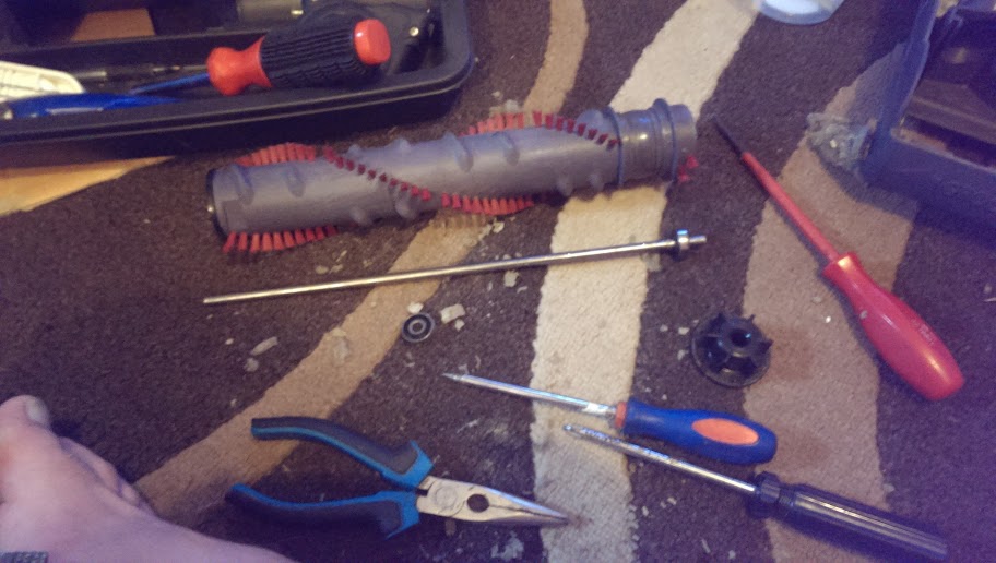

Brushroll next
I think it was needed, although the old one still groomed nicely tbh
I fitted the old end caps onto the new brushroll, as the old ones have edge cleaning brushes on
and had a test run. sniff sniff, mmm, whats that burning?
 :censored:, there's a difference between the end caps after all. New end caps quickly fitted and...
It doesnt come out well in the video but the motor is quieter, smoother, doesnt make odd noises on wind down, the suctions a tad improved and it doesnt run anywhere near as hot!
