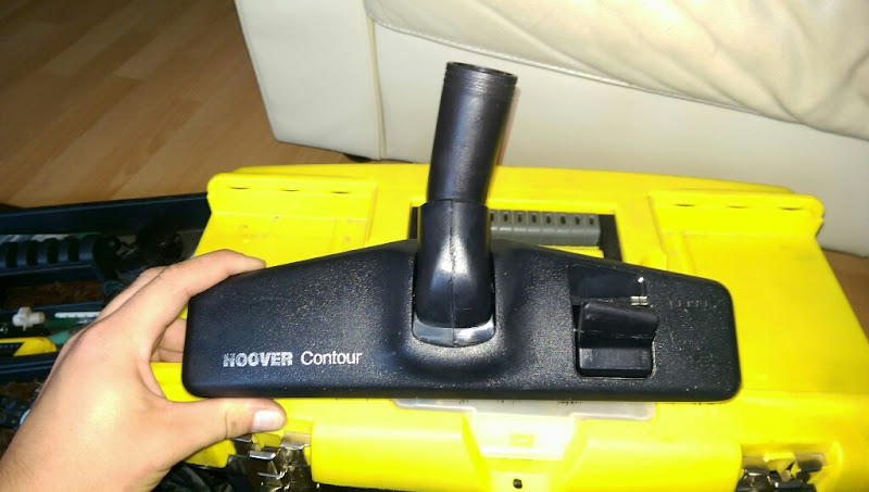

So, this morning, she was all washed and dried!
I started with the floor tool
which came up very well
These are lovely, lovely floor tools, easily one of my favourites! Shame they go so rusty when they start.
