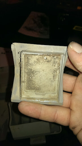

Was blocked solid

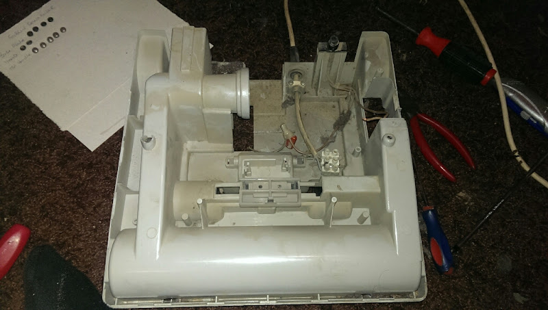

A reference shot of the wiring

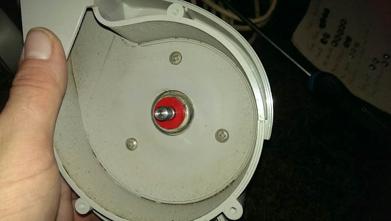

Fan wasn't broken luckily
Fan off

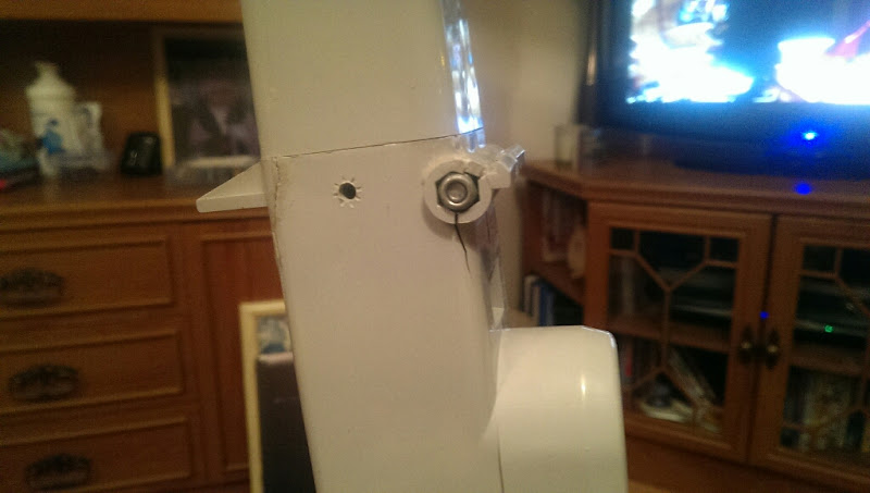

The damage on the handle top. I did try to glue it up sympathetically but I put one initial tweak on the screw and it went again, but didnt get any worse whislt I nipped the screw fully up so it can stay!

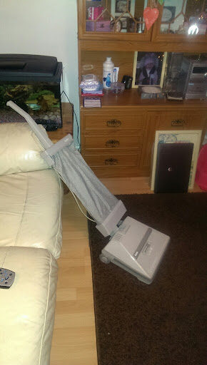

Only joking, she stands now!
