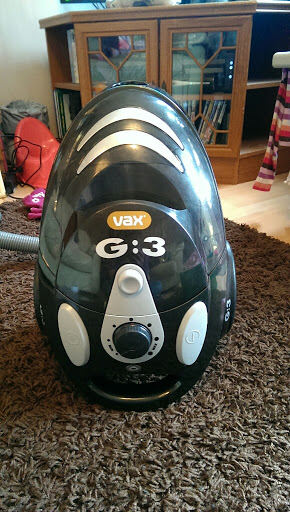

I remember getting this, a lady posted up on a local selling site asking if anyone wanted 2 free hoovers, and 4 people tagged me in the post. Got a nice DC04 Absolute+, which is long sold, and this. It's idential in pretty much every way to a Vax Centrix 3 I had a few years ago, which was shite tbh, but she wanted a cheap vac, a cheap vac she shall get!

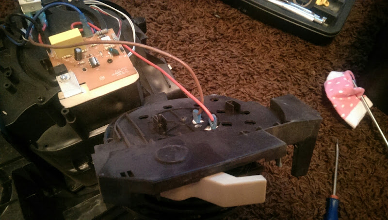

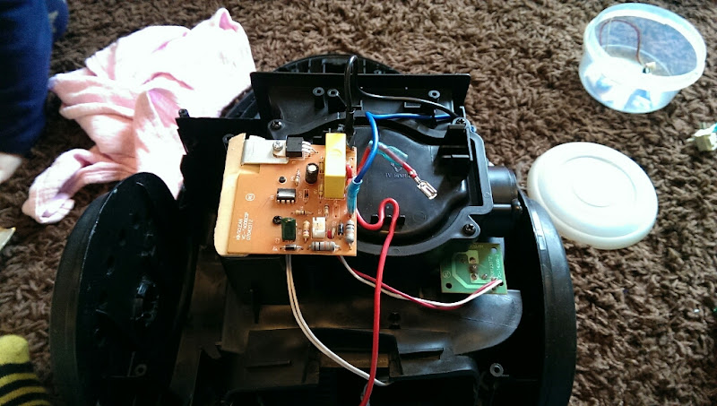

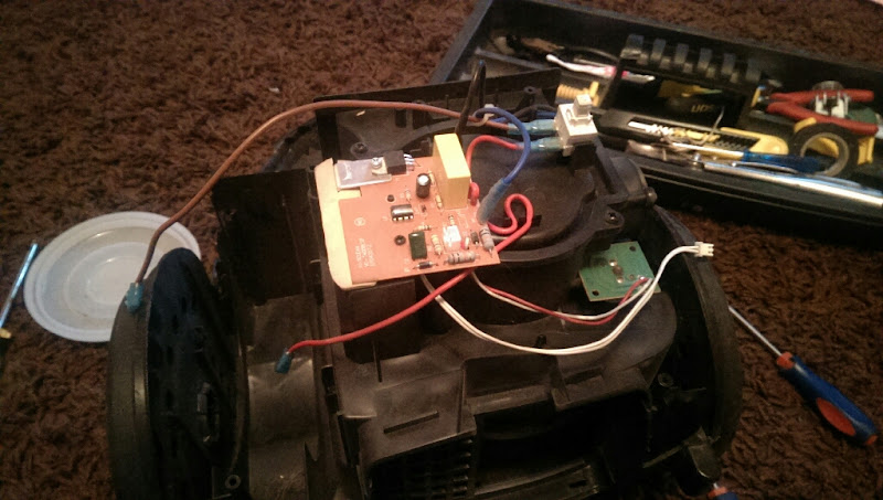

Under the lid was the speed control board and led light for blockages
An internal chassis unscrewed
There was a roller to help guide the cable out
Speed control module
and the LED board

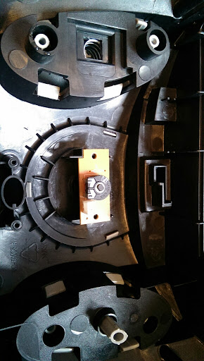

Speed control knob and trim pops out
The pedals pop out now

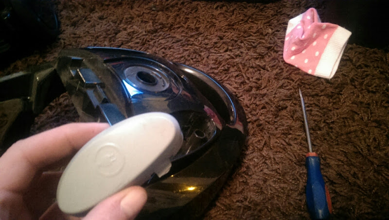

the 2 blingy chrome trimz unclip from the sides

Onto the electronics now
Power switch out
Motor wires
Managed to snap the corner of the PCB off. The internals were still ok though, so I put a drop of superglue on it to sort that...

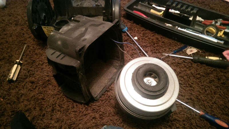

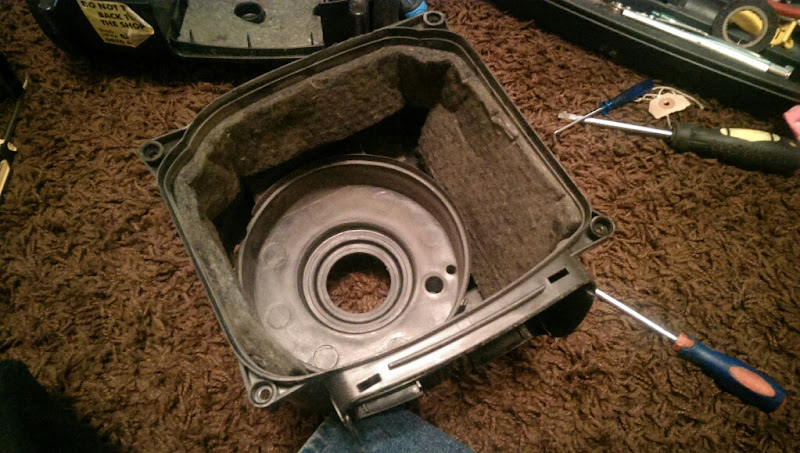

4 more screws and the motor housing pulls up, and the motor falls out

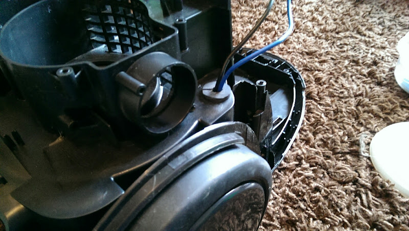

This bung held the wiring in
Sound deadening
Pulled it out for washing
2 anti vibration bungs were on the bottom of the motor housing
The beast of a motor is removed (horrible chinese screamer..)

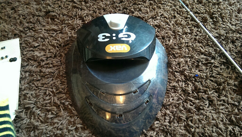

Cyclone shroud removed
4 screws remove the top shell
2 more blingy bits are removed
This chap here ensures the cyclone cant go back on (without a flatblade screwdriver) without the filters in place
The release clip pops out with a bend of the housing
The only rubber seal on the whole machine that is removeable
and the cyclone was removed!

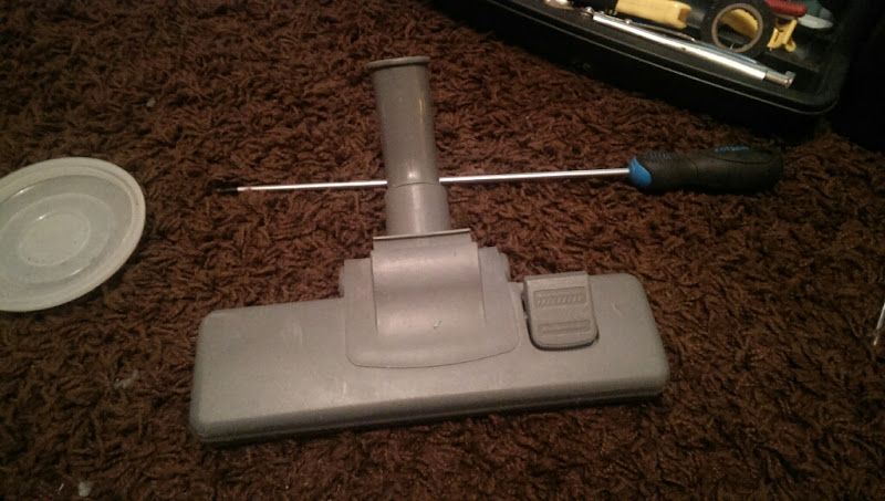

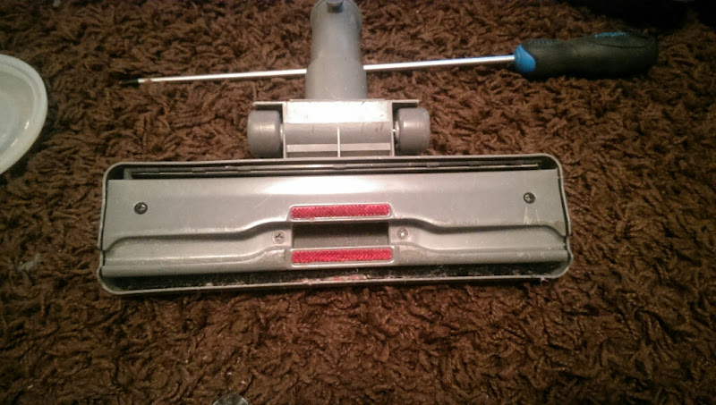

Floortool next
50/50 of the brush
Much better!
at the back was a rubber squeezee, which pulls out

Sound deadening fitted
motor located in the bucket
and fitted into the outer housing
wiring bung ready to go
lower sound deadening fitted
with a surprising amount of faffing the two peices were bought together, with everything wanting to fall out at once...
