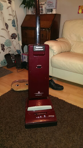

I saw this on ebay for an incredibly cheap price, so, one thing lead to another and it was delivered to work last week. I took it round to mums at lunchtime and unpacked it
November 1984
Back at home, I had a closer look
it wasnt too great out the box. The belt kept slipping off on the lowest setting.

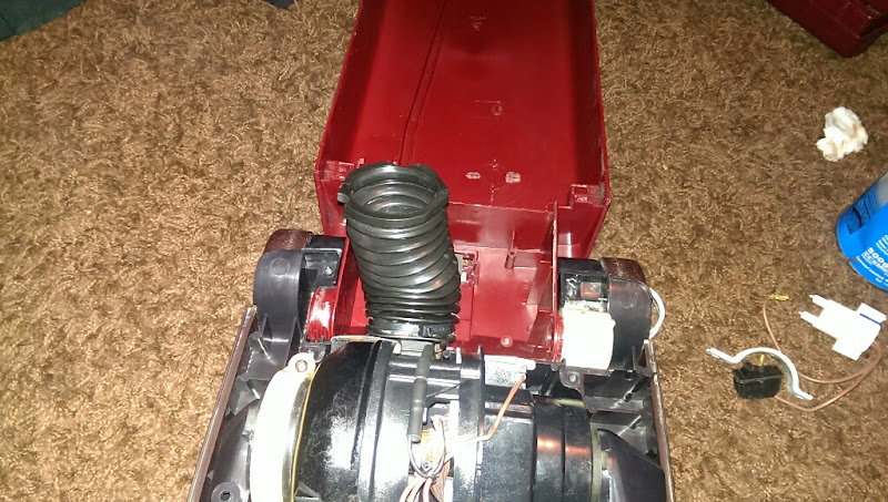

Crap pic but the cable tie holding the bellows on was removed
Motor clamp removed
and the motor lifts out

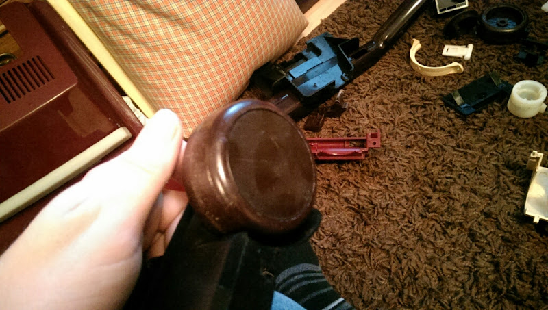

On the early ones, the front wheels are held in with brackets
The underside was covered in a layer of filth
Height adjuster out

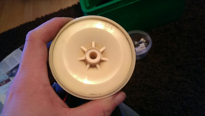

Wheels off, and the outer caps need to be removed first. The tabs pop out easily from behind
Wheels are held in with small circlips

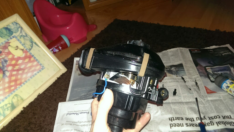

The fan case comes off now
The motor casing comes apart now
After the fan... which also had red stuff underneath it
Wiring reference shot
reference mark made on the housing so it goes back together the right way round
4 screws out and it seperates

sat the coil back onto the fancase
top ancilleries back in
Wires re-fitted, and a new cable tie fitted

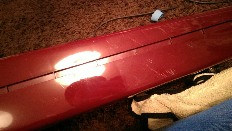

Last night now, and I waved SWMBO off to work, Eva was at granny and grandads, so I taped up the decals on the machine
and got the rotary out!
Not all the damage came out, but the gloss and clarity came right back into the plastic!
Once polished and buffed, I covered it in a layer of wax and left it to haze
I found the height wheels spring under the sofa so fitted that

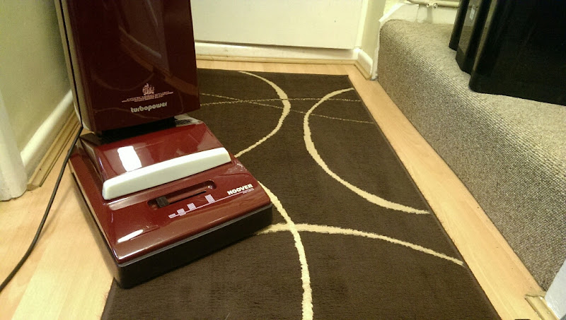

All the wax was buffed off, and she was done!
It worked much better after that!
