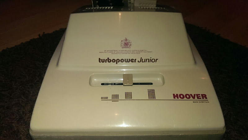

The Turbopower Junior U1100 is the first Turbopower Junior. I've always wanted one! Thanks to a fellow collector, I now own one! (and a fair few other machines now!)
May 1985, nearly 30 years old!
Hoover were still at Perivale by this point

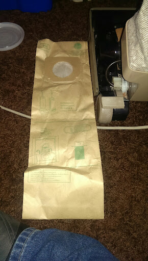

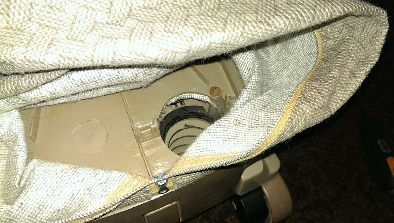

The bag has a hole in it now sadly, but they are pretty unobtanium now so not too upset
It had a genuine brand new bag in it which was nice. Put that to one side for now
However, it didn't sound too healthy... The first time I fired it up it was jammed, then there was a crunching sound and the motor started to turn to the standard in the vid...

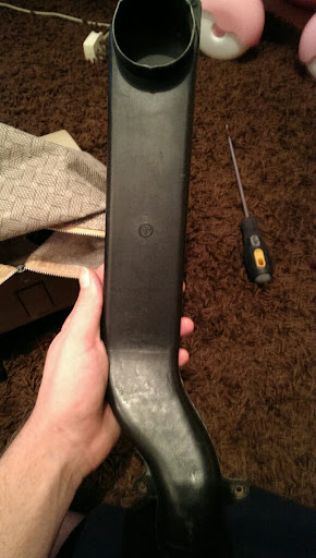

Bag fill tube off
One of the screws was quite rusty, but undid nicely enough!
All 4 screws undone and the bag assembly lifts off
The base lifts out of the bag

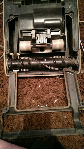

Onto the underside next
Activator is in good order
Belt guide cover off
2 screws later and the hood comes off. No damage to the fixings either!!
Furniture Guard off

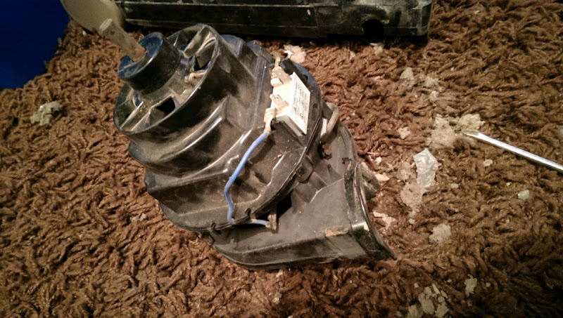

I was quite looking forward to getting the motor apart to see what the issues are, and it started quite early on when I took the fancase off and the fan fell out...
Had stripped itself clean somehow! New fan obtained from the shed.
Spindle looked fine though, must have worked loose over the last 30 years
I'm not 100% sure this is the original motors, I always thought early motors to have a different wiring setup, and different carbon brush connectors. My only old motor is fit for spares as the coil is damaged so this one will have to stay.
Oooh lovely...
Carbons look good though...
Usual buildup of smeg under the top fan

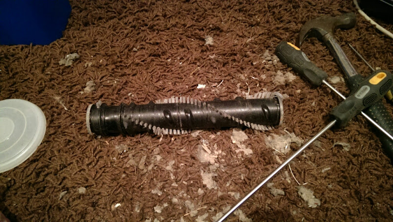

Onto the activator now, which wasn't too great at spinning
Looking good...
t'other side
This was seized, the axle was just spinning around the inner bit...

I rebuilt the activator with new bearings, end felts and end caps
and a new belt

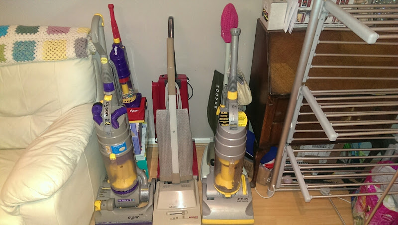

And now it sits next to the DA001 and 652A for polishing...
This is now my earliest Turbopower! Sitting behind it is one of the latest from 1996...
