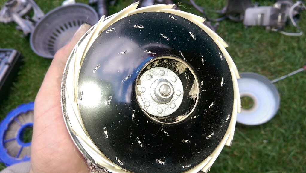

So, I had a look at the motor yesterday. This isn't a guide, I'll do a proper rebuild thread in time, this was just repair!
t'other wheel off
These worried the hell of me until I realised they screwed in and I didnt need to remove them...
Aha!
Mmmm, that looks like a dc24 motor...
Took the tco off the 24 motor
The 50 motor looks like it's beginning to get ill
BUT the 24 motor wont fit, as the carbom holders are wider, and it fouls the casing
Better see if the 50 motor can be rescued then
 :censored:
Scraped the worse out
Then into here for 2 hours for the rest
Cleaned the rest of the fan out with a brush
Had to do THIS to get to just this bit!
Much better! (after sticking it on the hob for 2 minutes to dry...)
50 on the left, 24 on the right
Gave everything a brush off and lobbed it back together
Annnnnndddddd.....
