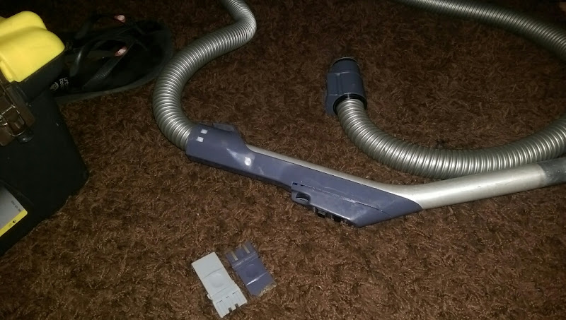

Along with my other dolphins, I had a few spare hoses, and the locking tabs are set up to take the power connectors that were never fitted, so I took one off, and took the remains of the lavendar one off the broken hose
You can see the remains of the locking tab still fitted to the hose
Removed the remains
Old v new
The contact strips pop out
and fit to the new tab
The other part of the contacts sit on the hose, and sprung bits of brass join them up
Some re-bending of the brass tabs to provide good contact and the new locking tab locks on

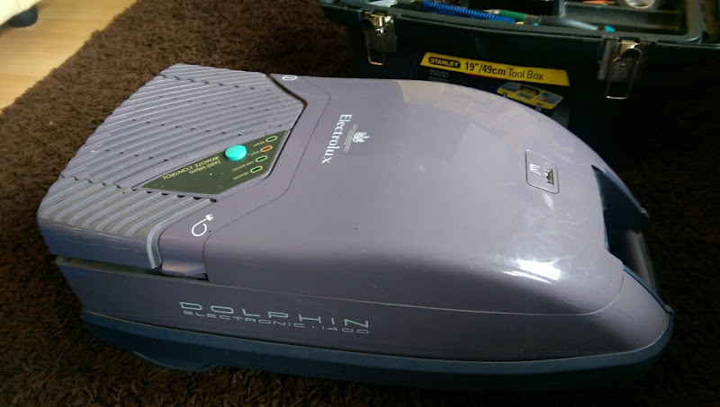

This is the machine in question
It's been repaired before by the looks of it

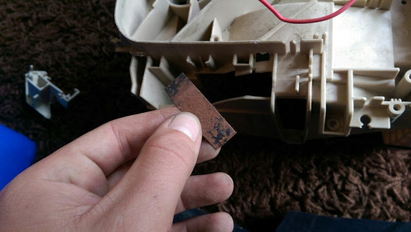

I broke the remains off the board, and had a look
A layer of something wasnt there to provide the contact, lost forever in 2 house moved

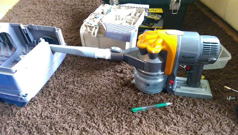

So, I had a look at the machine

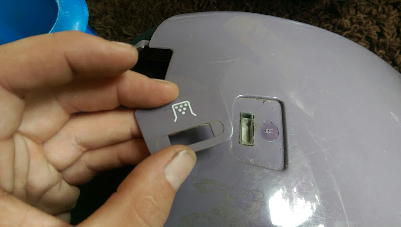

The decal was loose anyway, so off it came
Underneath, the bag fill indicator is held on with hot glue
Seperates out easily

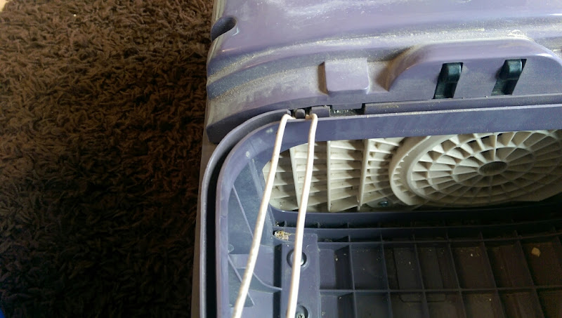

The wires run under the seal, and enter the machine here

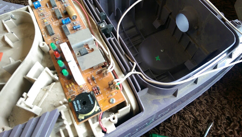

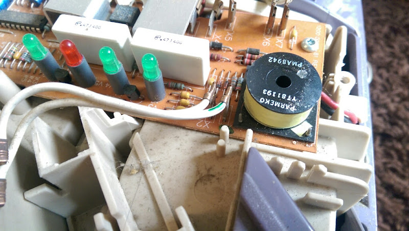

Under 3 more screws sits the best damn circuit board I've ever seen on an oover
More reassembly markings

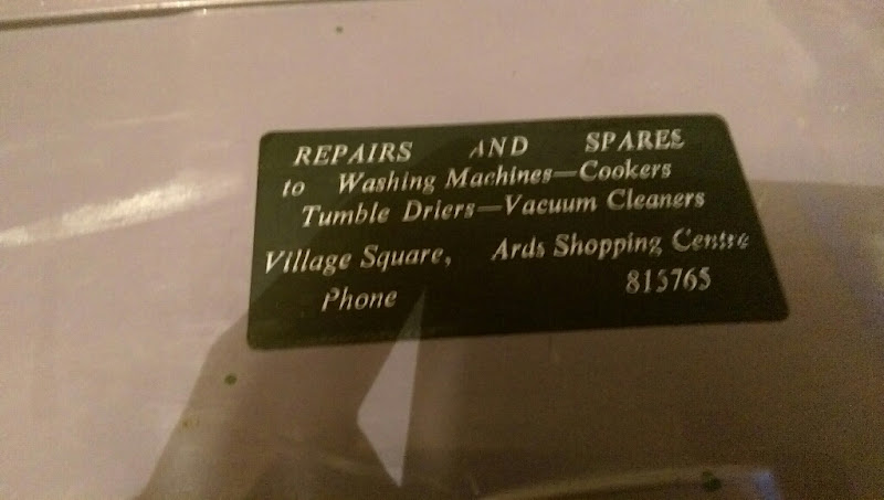

This was interesting, and may explain the repair shop sticker. On/off pedal had to be held in place with a bent hook of metal

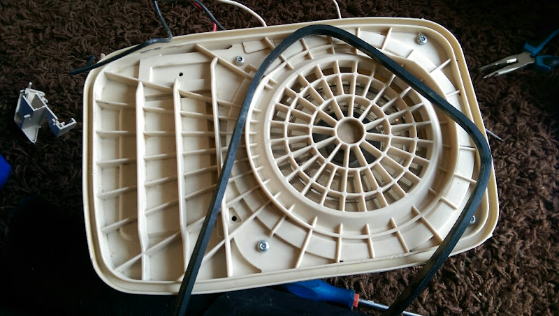

There's a seal that goes between the motor housing and bag housing
4 more screws

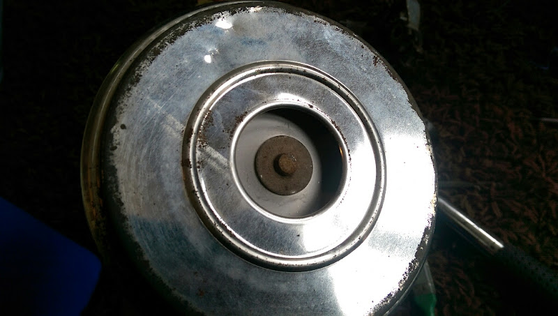

And a motor
It sits in a keyed recess
Motor seals off
Wires connecting up to the motor
This sticker fell off the motor
The top comes off the top of the motor by releasing 2 clips
This has seen some dust then...
The carbon brush holders snap out of the casting. The carbons wouldnt fully remove themselves, so I cleaned them up as best I could
That's as far apart as it goes
