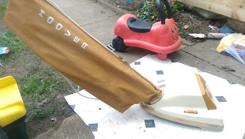

I bought this for 99p a few weeks ago!
The cord hook repairs are simply fantastic
The bag has a slight tear sadly
January 1977
Looked clean from the drivers seat

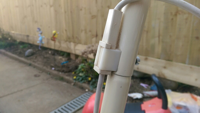

The top cord hook is interesting, not seen one like this before

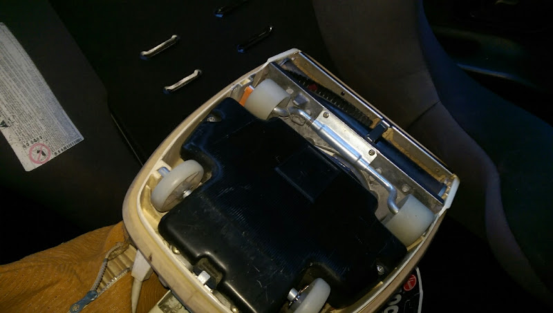

Underplate off
and the handle bail is removed with 4 screws
Circlip comes off the end of the large pin that goes through the handle assembly
The plate that moves with the pedal to push the locking bracket out the way comes off first
The main pin gets knocked through, and it and the spring removed
2nd circlip on the smaller pin removed next
Split
I gave everything a clean off. Main pin is a bit worn
Cleaned
All of this was just to clean the mechanism. The main actual issue is this
I made a new step with a pair of snips on one side, but the other side is thicker, so I'll grab a Hacksaw in the future and profile 2 nice new steps

Nice, I love the cable hooks  :)) pure genius.
Is that the top fill one?
The spring clips just clip in if the main body is plastic, alloy ones had small roll pins.
I managed to get 2 new old stock ... things... with the hooks that fit on the bottom of the handle, didn't know you could hack a new bit on them.  :thumbsup:
