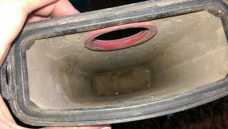

This blurry shot shows the inside is filthy, and going mouldy after god knows how many years in a garage and shed
The inner box slides out of the cage, showing the years of dirt that have seeped through, apparently the system was, for want of a better word, shit!

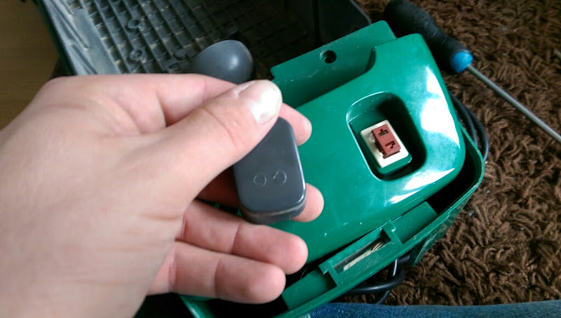

The switch housing is removed with 2 screws
which exposes the wiring
The switch cover pops off

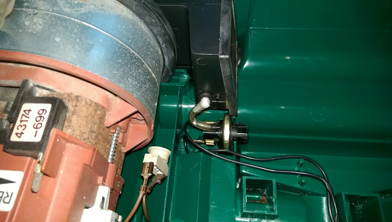

The main suction channel lifts out first, along with the little pipe that connects to the pressure switch that drives the bag full light
The pressure switch pops out of it's place on the chassis

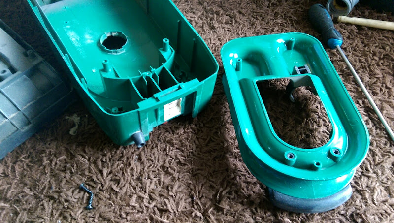

The clear blockage channel unclips, and 3 screws removes the base plate

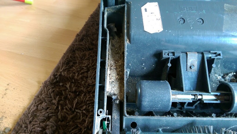

There was a bit of smeg buildup by the belt
4 screws release the hood
revealing some date stamps, and allowing the bumper to be unclipped

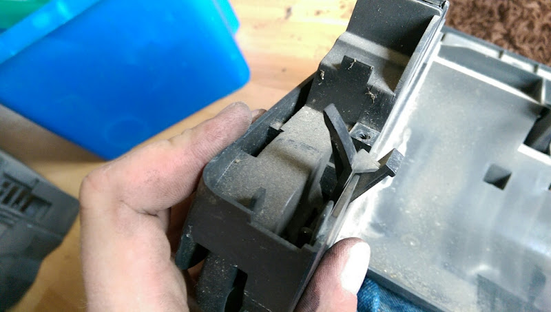

The release pedal unclips from the hood

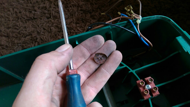

The choc block is removed from the chassis

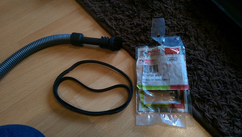

and a new belt that came with the machine

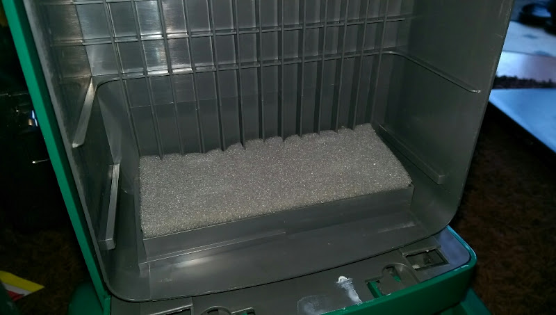

I found some new filters in the shed
and checked out the clean and dry permabag
All the staining has gone, which is good
