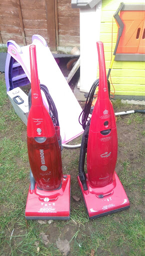

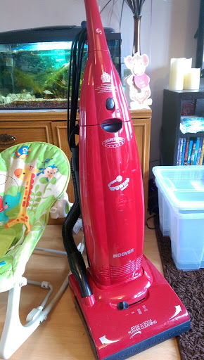

A fair old while ago, one of SWMBO's Aunts told me that she had been given 2 old 'hoovers'. She has some bagless samsung upright, which is at the end of it's short life, and was interested to see if I could do anything with the cleaners she had been given. I told her that of course I would love to help, bring them round.
Much time passed, but one day, when I was adjusting my throttle cable on the car, she arrived bearing gifts
One vacuum is a crappy horrible shitty chinese piece of toss, the other is a Scottish Hoover Purepower!
A quick look at the pair revealed that the Dust Manager(less) was missing a key part of it's 'cyclone' assembly, backed up by auntie mentioning that most of the dust missed the bin, and she had to clean the filter off after every use  :'(. Luckily, the PurePower had been spared any abuse as it did not have any bags.
I told her to leave them with me, and I would get the best one working. What I actually did was throw the DM into the shed, and take the PurePower inside for some love!
I had a genuine filter kit and some bojack bags for the PP, which helped it's case, plus, it's a fairly early PurePower, made in Scotland when there was still a shred of UK-Ness about Hoover, although I imagine that when this was built (1999), the executives were touring the sweatshops of china in readiness for the move...
I thought this meant it was made in Wales, but someone far more knowledgable than myself said that the warrant was in the Merthyr name as that's where the head office was (washing machines were made in Merthyr), the vacuums made in Cambuslang (backed up by the Back to the Floor programme that I had forgotten about, which showed piles and piles of these, and the early Telios machines in the warehouse as no one was buying them!). The PP machines have their fair share of issue's, having been pared to the bone by this stage, really early ones are reported to be much better, this is a 'middle' one I think, they are really cheap and nasty now
So, possibly the last UK Hoover model there is. Let's see what it's like (If I was doing a video I'd have put on a RustySkull type voice there...) but I'm not, I'm typing this with everyone in bed, and my 'night' lemsip pill kicking in, so you'll have to provide your own version of voices there!

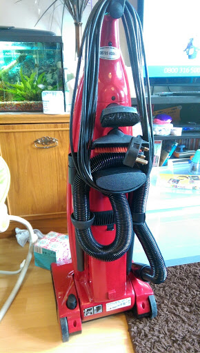

It has all it's tools
The dusting brush was full of fluff
which soon picked out revealing a very good condition dusting brush
The upholstry tool was ok
Extension tube and Scabbard

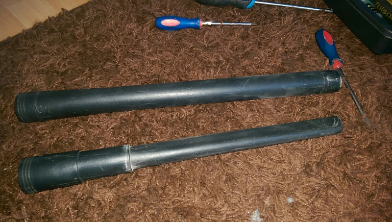

The very long hose comes off the machine
and strips apart for washing

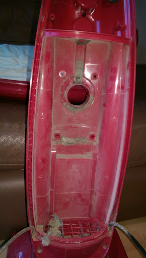

The pre filter sits inside the bag compartment
We see our good friend Plaster Dust here
and a good deal of it seems to have got past the filtration system too, but then not even Dyson or Sebo are immune from this

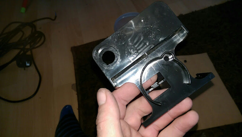

This is the pressure switch that activates the bag full/blockage light
and once removed releases the plate that holds all the wiring together

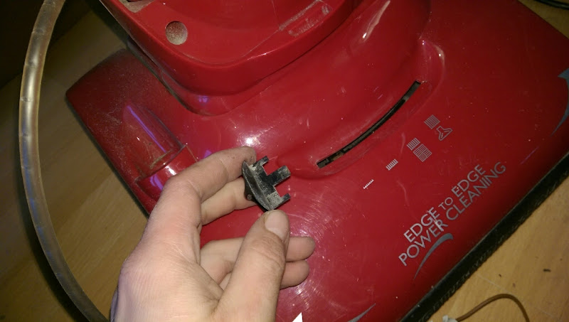

This bit was a bit do or die, this is where most Purepowers, from the very early ones right up to the one's being sold today break
It seemed to work ok, but would there be any hidden damage?
some tentative flicking of tabs
and it was released
Luckily, all in good order. It was a bit stiff to operate, hopefully a good wash and polish will free it up a bit

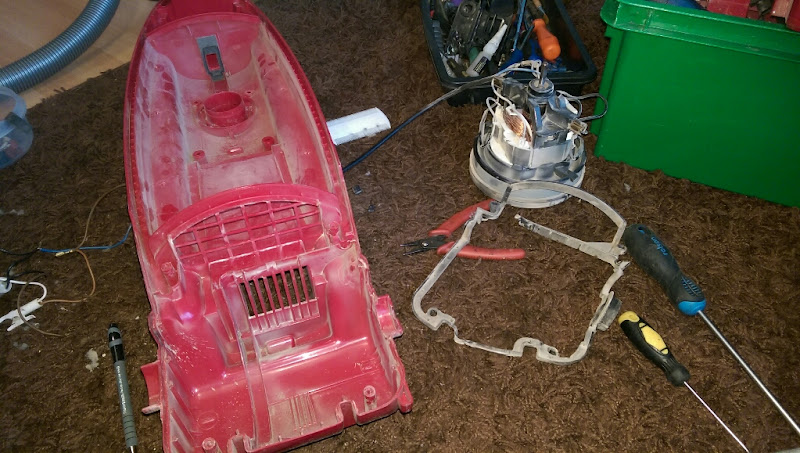

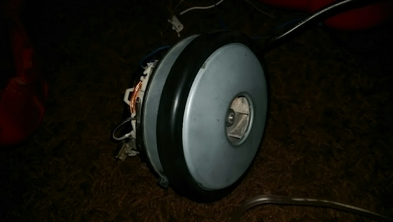

That part done, it's time for the last bit, the motor! Motor cover unscrewed
and the motor and seal removed
Fancase seal removed from the motor
This is the same motor that was in my Vortex, and it's in much better condition than that was (before I replaced it with a NOS motor anyway)
Not being wound up to 2000w probably helped it here
With the motor removed, the machine was stripped! The washing machine had finished too, and I learnt a lesson...
