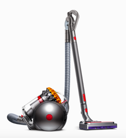

As there is no visible damage to the grey cable nor to the black and white leads emerging from the Cable Retractor Assembly (see photo) to the motor, I conclude that there must be a loose connection or damaged cable within the Cable Retractor Assembly.

That photo above isn't a DC28c though, although the cable rewind photo looks to be. Its the same rewind as the DC39 FYI.

And you consider that the photo in my first post is not a DC28C?
Well, I'll be blowed!
It looks identical to the machine I'm attempting to repair which latter is clearly marked DC28C ErP in its nether regions.
Perhaps it'd be more recognisable if presented without some of the accessories.
