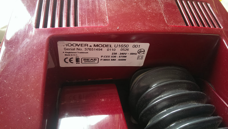

Made in March 2001, so VERY late for one of these! They stopped altogether in late 2001. Not hard to see why these didnt sell, to quote someone from facebook "Why buy a machine that looks like its from 1984 when you could have a DC04!"He has a point!
Note also that Candy have just called this a Junior, rather than a Turbopower Junior as they have been known since 1983...

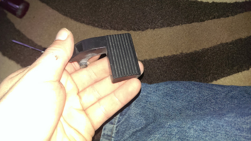

Release pedal falls off during this bit
Release mechanism. If you get a turbopower that leans or worse it's the bit this sits on thats snapped. Can sometimes be glued up.

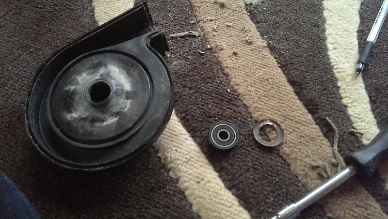

Candy must have sealed the fan chamber up, or someones been here before. I always seal it up, stops so much suction leakage! Up to 1995 (my second oldest) they were just pushed together
Fan off
Motor split

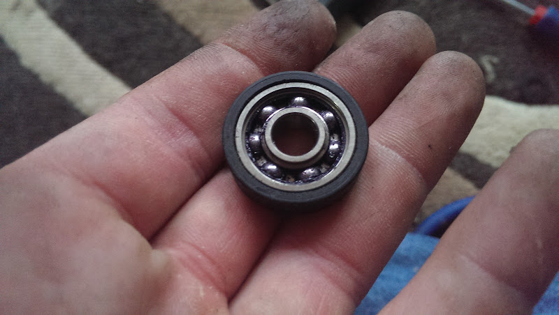

Bottom bearing out
Looks like these later bearings can be re-packed which is nice

First job was to grease the top bearing. Couldnt get the other one available sadly!
