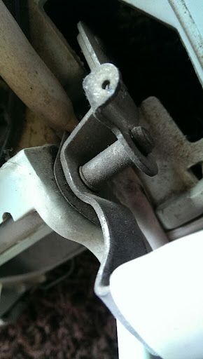

Hefty spring under the rear wheels!
The bracket that holds the axle down

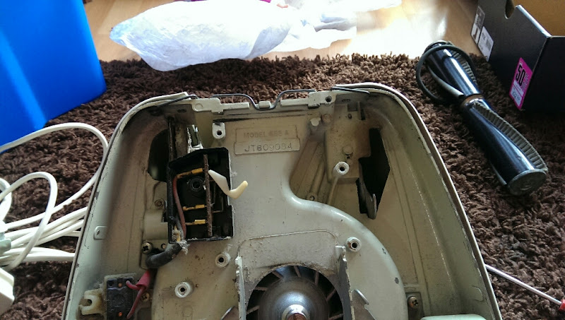

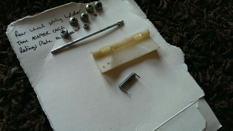

A few more screws and the ratings plate and tool adapter plate come away

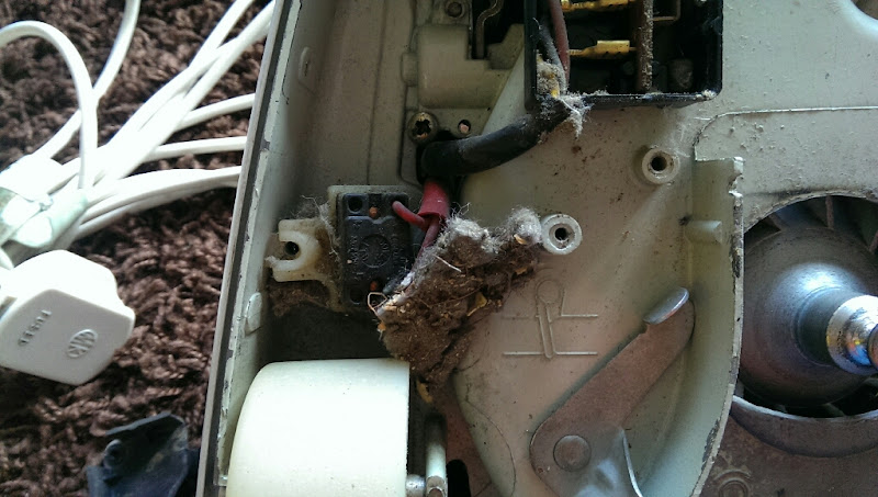

The flap and 2 speed switch were choked with fluff
Quick reference of the spring position
and apart!
Under this panel sits the 2 speed switch. When the tool adapter is inserted, the speed increases for the tools. It is possible to stick this on permantly for normal use, but it doesnt need it!
More greb under the on/off switch cover

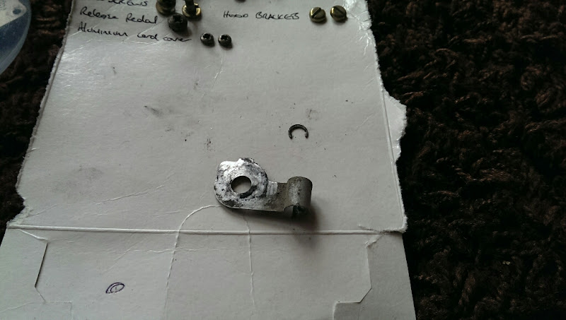

Another circlip holds the cord holder on
Bit of tappy tappy and the axle comes out

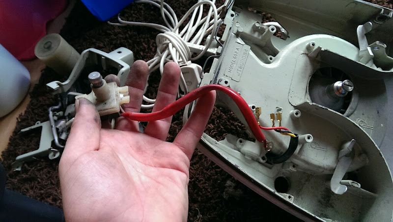

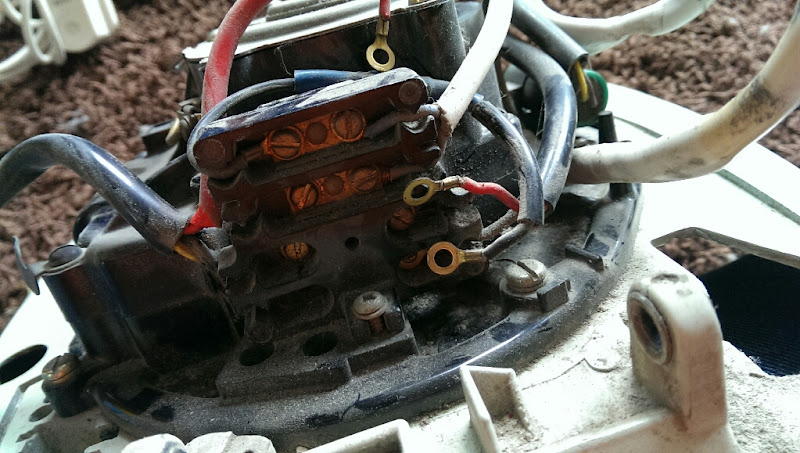

Time to make a start on the wiring now!
The red cable loops from one side to the other, and connects with the red cable from the hi/lo switch (50 years before Numatic were Hoover...)
The wire above that is also for the foot switch, so now that can be removed!
and done!
The whole connection panel unscrews now

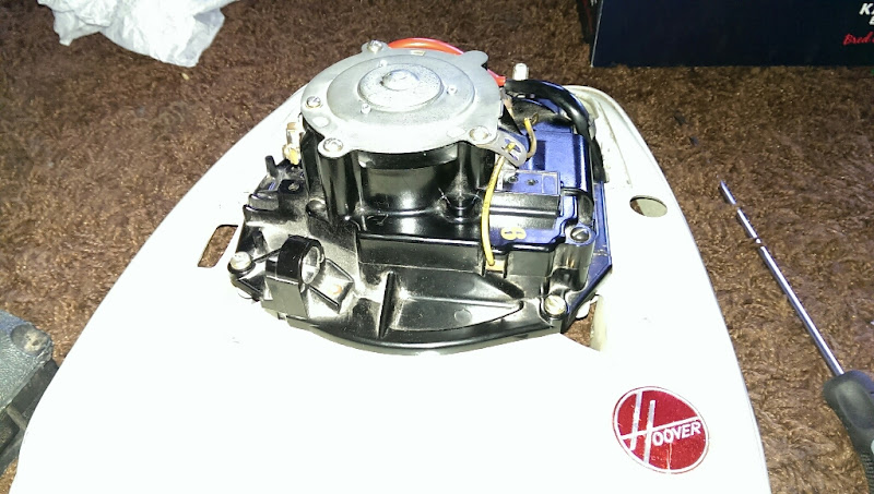

4 more screws and the motor falls off!

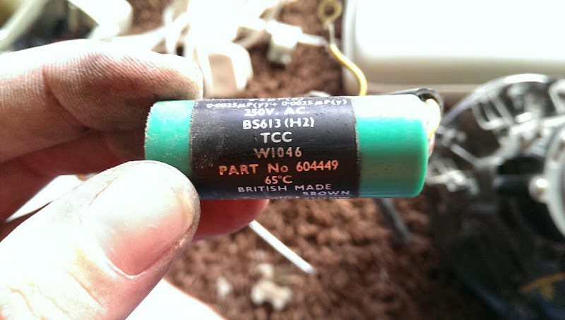

this clamp holds the capacitor on

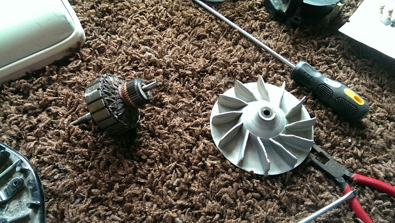

Fan off, all this was packing the fan out
the armature pulls out at this point
