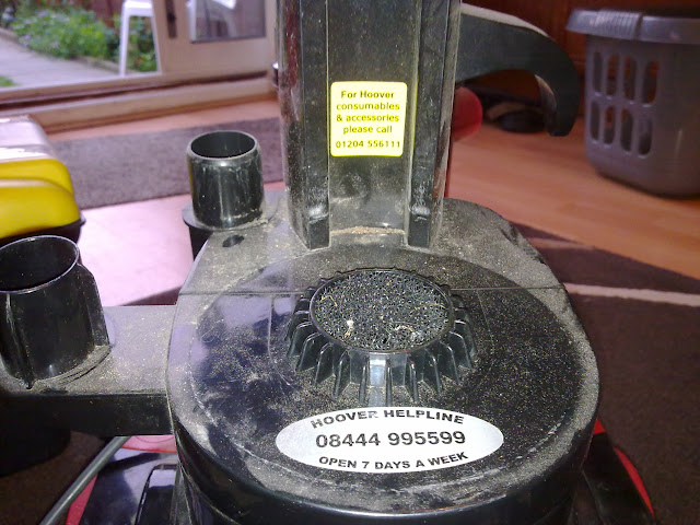

My camera decided the back door was more interesting than the post motor 'filter'
Exhaust filter was minging

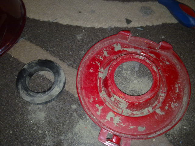

A seal off
