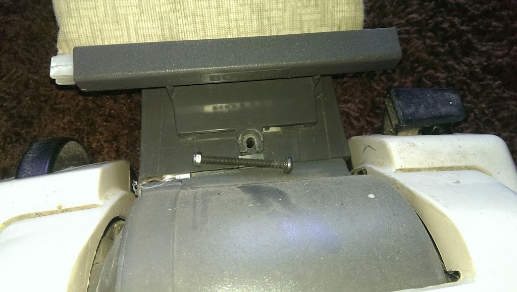

Not sure if this bolt is original or notm but it does a good job. Holds the handle onto the base, and the bag bottom in place
Bag top just slides off the bag

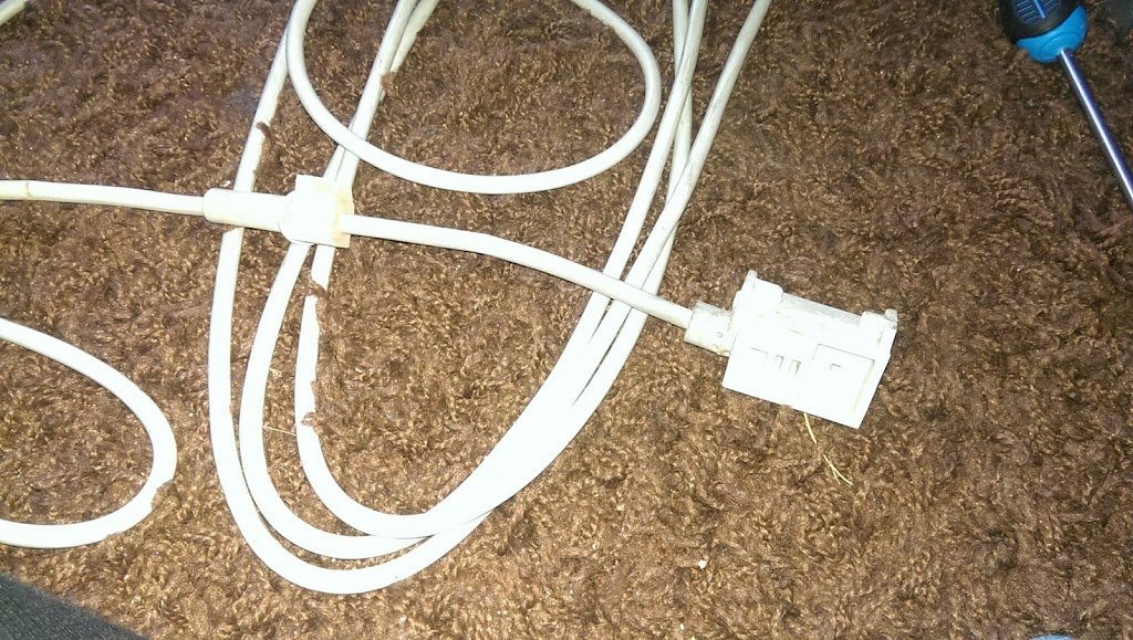

The cable unplugged from the motor

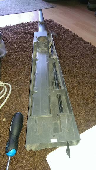

I moved onto the bottom, and took the base plate off
The top hood snaps off with some tabs, no nice screws here

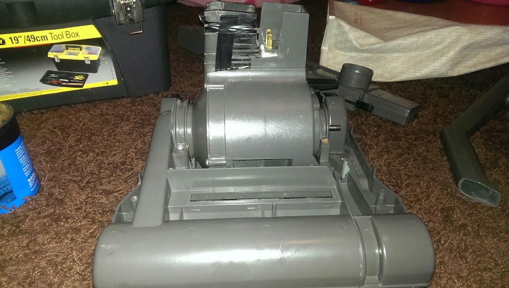

The motor housing can be removed now, This is a one piece affair, housing the motor, switch and pretty much everything

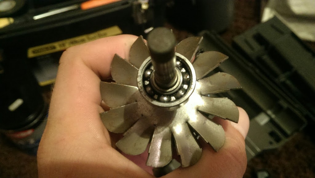

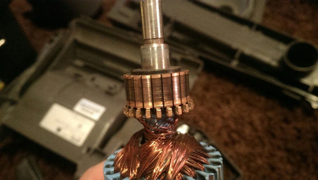

The armature wasnt too bad, but I gave it a quick clean with some fine wire wool anyway
The fan had seen some use, sadly a Turbopower fan is a different profile so I had to re-use it
