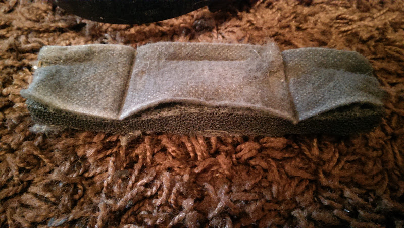

filters were manky
Pre motor HEPA was certainly quite dead
The outer filter pulled out of the cage, and the internal one wasn't too bad underneath
I cut up a random filter from the shed, and it worked but tbh I wasn't impressed
