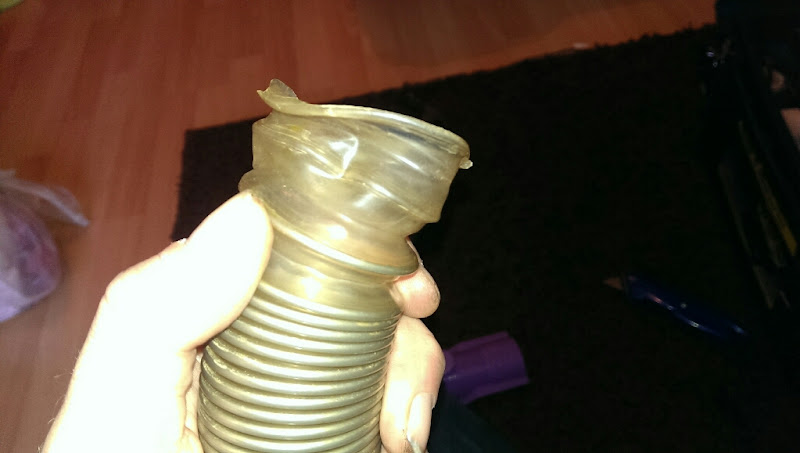

(ignore the hose cuff, just grabbed the first end I found, as when the hoses arrive I go through and chop the ends off to keep the hoses tidy, then just match them back together afterwards. Need to get the brake cleaner out and remove the tape residue before using it)
Tidy up the end of the hoe, snip any excess coil back to a good part of the palstic, and trim the plastic back
