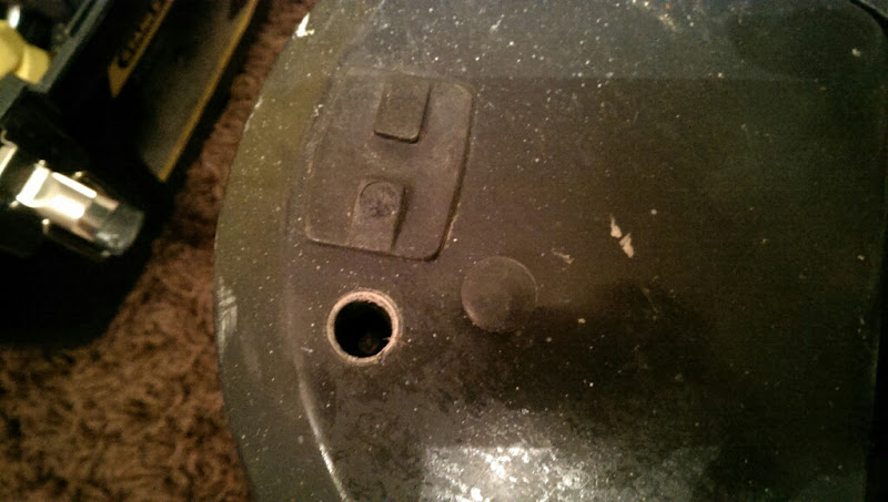

The castors and holder snap off the bottom
and knock out from above with a screwdriver

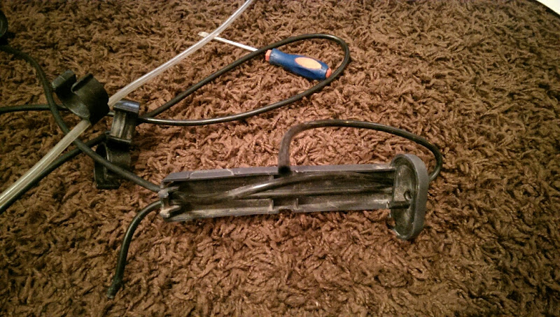

Had a look at the solution tube next
Dirty

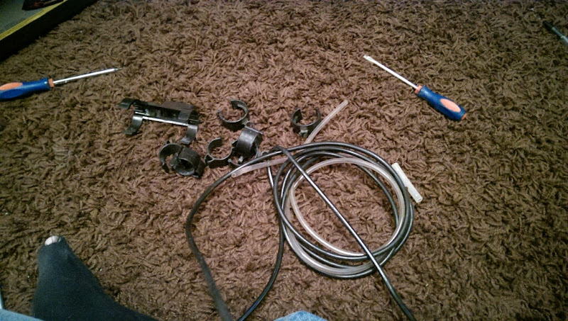

Sadly the little tube snapped off at a join when removing it
All split and ready for washing
Found some old Vax tubing
Cut to length

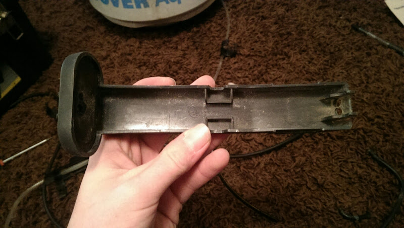

Handle split down
Switch cover removed

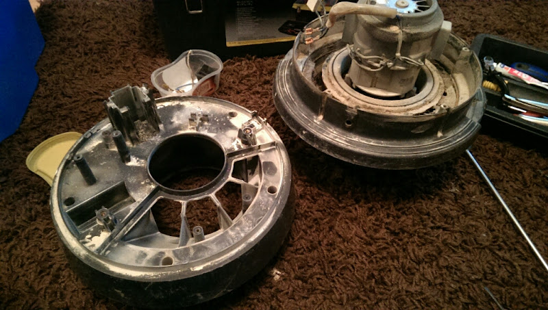

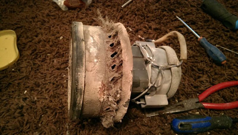

I vacced off the worse, and got some movement back into the sponge, and withdrew the motor assembly
Yummy
This forms the start of the solution tube network
More scabby foam
I think this machines seen some use
People who have had these machines before were screaming at me to check the fans...
Motor seals off
Not being too fussed about a few dents on the fan case I hammered it off
Took the top cover off
Carbons are good, but worryingly wet... (in its defence, I may have performed a partial water change on our fish tank by sucking 2x loads of water out of it using this before the stripdown...)

Cleaned the motor up as best I could
Put the top fan back on. If I ever find myself with some de-rusting solution one day I'll pop this back apart and give it a soak and see what happens. For now though, it can stay
Top fan on
and fitted the fan case and carbon brushes.

Cleaned the motor seals until they were brand new again and fitted the motor

Feeling excited to see if the motor work did any good, I fitted the top to the in bits base that was awaiting being washed and switched it on. Sounded so much healthier! As the comment on that YT vid says, it doesnt sound perfect, but tbh the bearings are great, so the rust and corrosion must have thrown the fans off balance slightly. I can live with that, this is never going to be a concorse winner...
