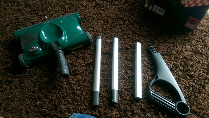

Handle apart

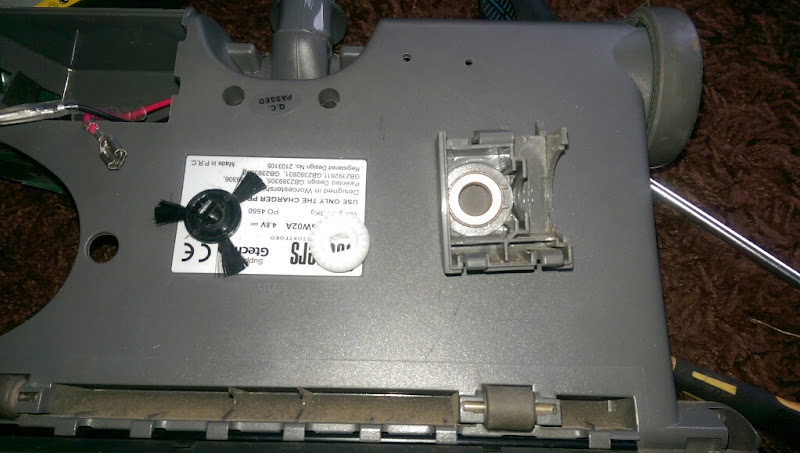

Onto the underside now
and into the battery compartment
Wiring reference shot
Even the battery has been rebranded!

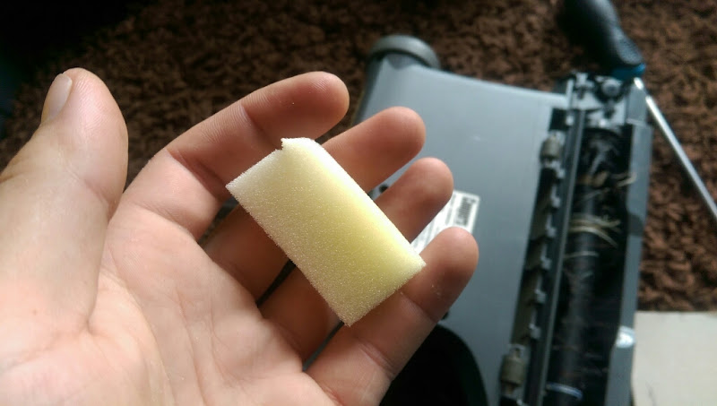

This bit of foam fills the gap that I imagine is taken up by a bigger battery on some models

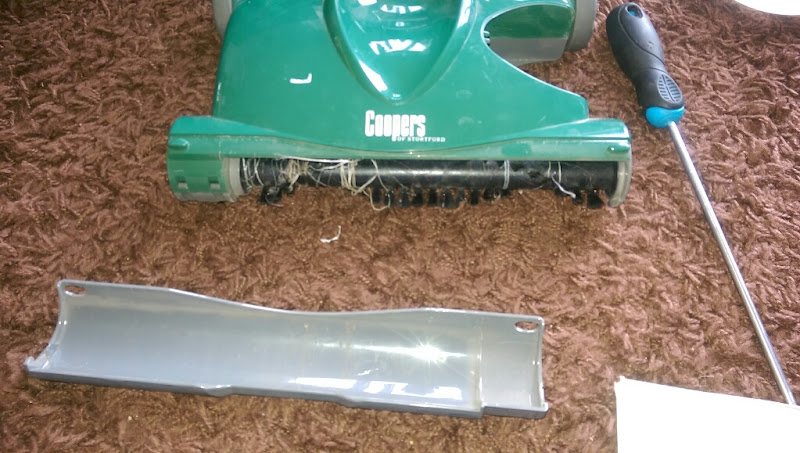

The brushroll cover pops off anyway for maintenance without tools
Brushroll was full of thread and bits of carpet

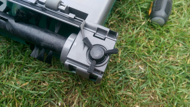

The edge brush spins with the brushroll, and is removed by squeezing the tab
The brushroll fell out at this stage too
The edge brush splits down by squeezing the release tab

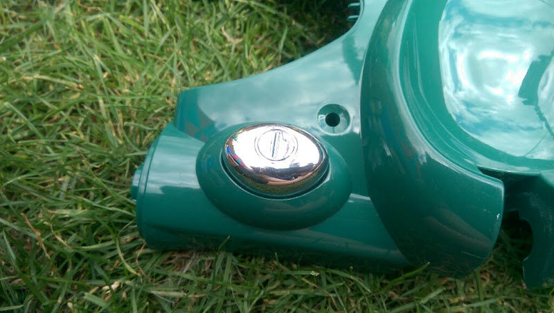

A good polish with silicone heavy car polish to shine up the green
And it's done!
